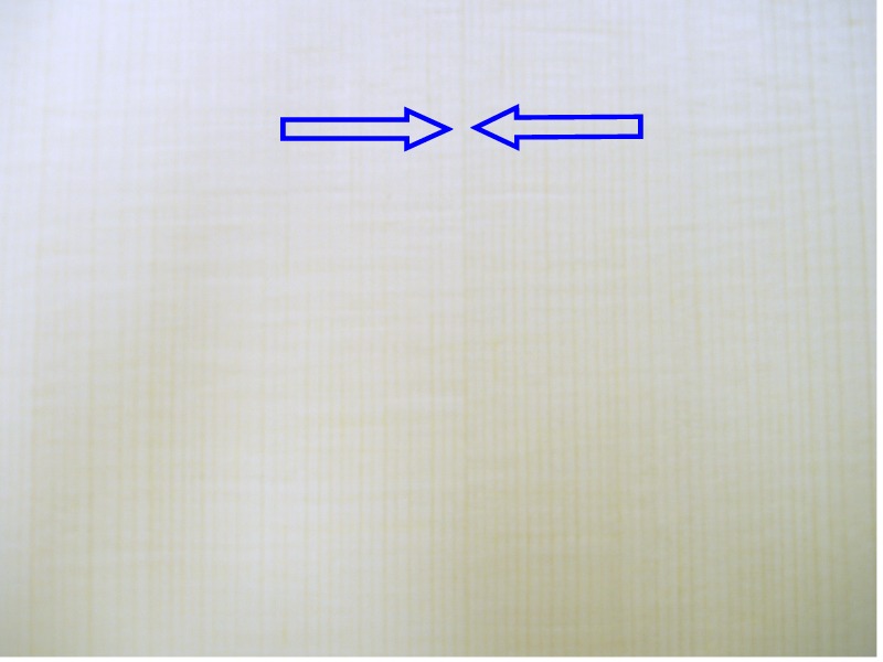

I use both jointer and handplane, depending on the wood and the jointing problem, both are tuned, honed, very sharp.
It's entirely possible I jointed this one badly, candling can sometimes be tricky. That's the question I'm trying to answer, did I joint it badly or is there another problem. Here is my best attempt at a close-up picture. I'm going to try Shane's suggestion and do some spot finish, see if it stays.
Marc39029.6305902778
PostPosted: Wed Nov 08, 2006 5:52 am
To me, it looks like you have put two grain lines together, making it look like one very thick one.
PostPosted: Wed Nov 08, 2006 7:07 am
Posts: 606
[QUOTE=Aoibeann] To me, it looks like you have put two grain lines together, making it look like one very thick one.[/QUOTE]
Could be, I'll have to get my loupe and take another look.
